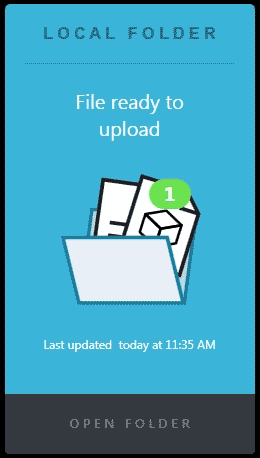

5
Take a CAD file and move it into this folder on Windows Explorer. You will see on the Workbench App that you have files to upload. Click to view them, and click "Upload Selected" to begin the sync.
